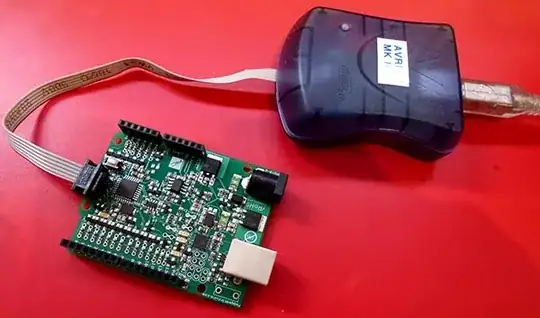

You can download the hex machine code from the Arduino by using an ISP programmer, like this one:
ISP programmer
A command like this could be used to read the flash memory and save it into myfile.hex:
avrdude -c avrisp -p m328p -U flash:r:myfile.hex:i
