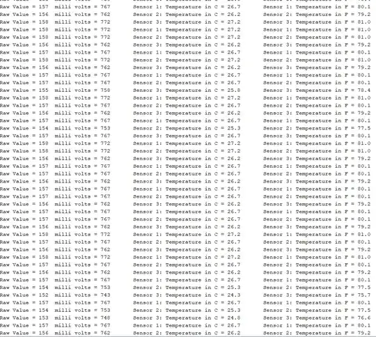

I have a question with Serial Print. I want the Sensor reading values to fall under 3 columns, and each column should have the readings from the same sensor.
Raw Value | Sensor 1 | Sensor 2 | Sensor 3
how can I modify this code do this?
Below I have posted my code and what I currently see using the Serial Monitor
    void loop(){
  RawValue0 = analogRead(analogIn0);
  Voltage0 = (RawValue0 / 1023.0) * 5000; // 5000 to get millivots.
  tempC0 = (Voltage0-500) * 0.1; // 500 is the offset
  tempF0 = (tempC0 * 1.8) + 32; // conver to F
  Serial.print("Raw Value = " );  // shows pre-scaled value
  Serial.print(RawValue0);
  Serial.print("\t milli volts = "); // shows the voltage measured
  Serial.print(Voltage0,0); //
  Serial.print("\t Sensor 1: Temperature in C = ");
  Serial.print(tempC0,1);
  Serial.print("\t Sensor 1: Temperature in F = ");
  Serial.println(tempF0,1);
  delay(500);
