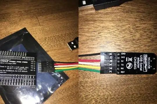

It is Robotdyn Mega 2560 PRO MINI and a Robotdyn CH340 which I have connected like this: enter image description here
I installed the CH340 drivers from here https://sparks.gogo.co.nz/ch340.html and I can see it in the device manager. Connecting the Mega 2560 Pro Mini lights up the L and On LED but when pressing upload (testing with simple examples as Blink) I get the error and neither RX or TX lights up.
I have tried everything I can think of. What am I doing wrong?

Try placing a 100nf capacitor on RST. That is usually required on an FTDI programmer.
