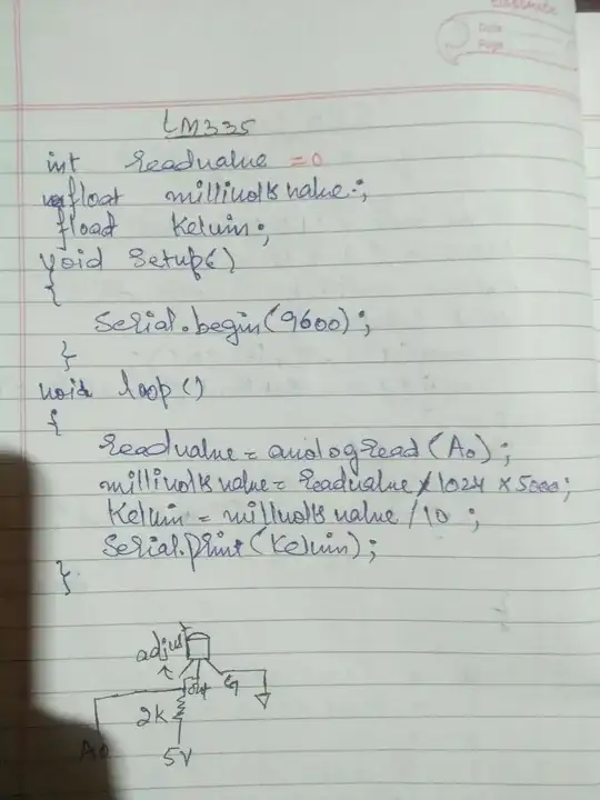

enter image description here try this one i have worked with lm35 using this code and circuit. i have done this thing with arduino uno but you can try it with esp32
