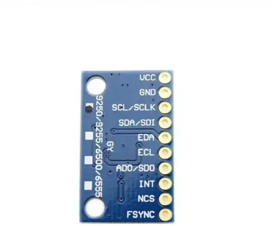

There is an SPI example code written, but I don't know about the connections. There are no MISO and other pins on the sensor which i use but its SPI compatible. How do I connect 2 MPU9250 to NodeMCU with SPI?

The MPU-9250 pins should be connected as:
  • VDD: this should be a 2.4V to 3.6V power source.
  • GND: ground.
  • VDDI: digital I/O supply voltage. This should be between 1.71V and VDD.
  • FSYNC: not used, should be grounded.
  • INT: (optional) used for the interrupt output setup in enableDataReadyInterrupt and enableWakeOnMotion. Connect to interruptable pin on microcontroller.
  • SDA / SDI: connect to MOSI.
  • SCL / SCLK: connect to SCK.
  • AD0 / SDO: connect to MISO.
  • nCS: connect to chip select pin. Pin 10 was used in the code snippets in this document and the included examples, but any digital I/O pin can be used.
  • AUXDA: not used.
  • AUXCL: not used.

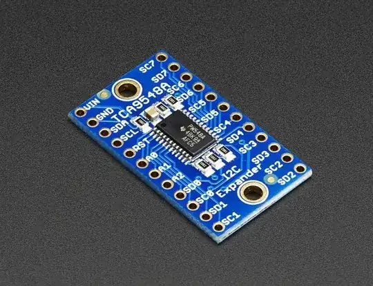

Another easy way of connecting multiple sensors with the same I2C address is by using an I2C multiplexer like the Adafruit TCA9548A TCA9548 I2C multiplexer This would allow you to connect up to 8 sensors having the same I2C address. Here's a youtube video explaining how to do so.

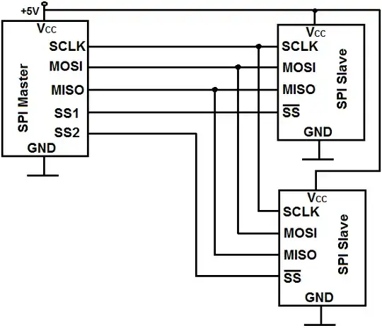

To connect multiple SPI components, you only need 4 pins on each 'slave' (thus sensors): SLCK, MOSI, MISO and SS (Slave Select).
The Slave select pin depends to which the master (NodeMCU in your case) is 'talking too'. So on your NodeMCU you will have 3 SS pins (one for each slave sensor). The NodeMCU should talk exactly to one slave device at the same time by setting that SS pin LOW (while the other SS pins are high).
See for the full article: Multiple-SPI-devices-to-an-arduino-microcontroller.
--Vcc: this should be a 2.4V to 3.6V power source.
--GND: ground.
--FSYNC: not used, should be grounded.
--SDA / SDI: connect to MOSI.
--SCL / SCLK: connect to SCK.
--AD0 / SDO: connect to MISO.
--nCS: connect to chip select pin (Any digital pin but in your example is PIN 10).
Also, you can check the connection from:
https://learn.sparkfun.com/tutorials/mpu-9250-hookup-guide?_ga=1.139382715.926858641.1470020364
