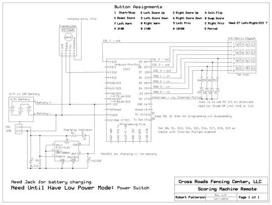

enter image description hereI made a simple RF remote control using a very similar method with a 4x4 kepyad, with diodes connected together to trigger an interrupt and read a keypress. After any keypress, the interrupt woke the processor (unmodified 8 MHz Promini with Atmega328P), it used keypad.h library to detect the pressed key, sent that out via a short RF burst (433 MHz transmitter) using the library (8 years ago now, drawing a blank on the name) that became the Radiohead library (find it on github), then went back to sleep. Lasts about a month on 2000mAH (or so?) LiPo battery that is secured to the bottom of the board.
As I recall, I had to write the outputs opposite of their normal state before going to sleep mode for the interrupt to work correctly, then restore them before reading the keypad.h value. Then put them back in opposite state before going back into sleep mode. Works well, but I only transmit one key at a time. I don't have complete details here, can post them when I get home later. You can see a picture of the remote at the bottom of this site - sorry about the scrolling, I managed to overwrite my index.html file that had link/tabs to jump to the various areas that my son did up for me. http://www.crossroadsfencing.com/BobuinoRev17
