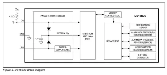

I have measured resistances between the temperature sensor's wires:
  • '+V' to 'data': 4,7 kOhm
  • 'GND' to 'data': ~3 Ohm
I think between the GND and DATA sensor wires resistance should be much higher - am I right? Below you can see a block diagram copied from the sensor datasheet (https://datasheets.maximintegrated.com/en/ds/DS18B20.pdf): ds18b20 block diagram
Maybe black and white wires are +V and GND (which one is +V?), red is data? Or it's broken? Or something else?
