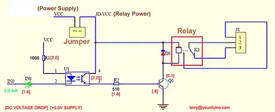

If you have a relay that is activated by a LOW or ground path, and is deactivated by an open circuit or HIGH signal applied, then you could try switching the pinMode to act as the HIGH or open circuit.

I'm not sure which relay module you are using, but if it is the same as this type, using INPUT_PULLUP will work.

When the relay module has floating inputs (as far as I know they do not) then you need extra hardware to pull the signal high with a pullup resistor to keep the relays disabled during reset.
