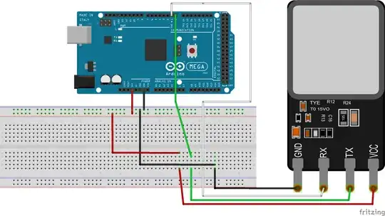

My circuit connection is:
  • (Green) TX => Pin 0 [PWM]
  • (White) RX => Pin 1 [PWM]

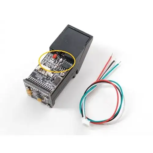

//It doesn't respond when connected to 5V, it only heats up
  • (Red) VCC => 3.3v
  • (Black) GND => GND
The connection is illustrated below:
The code is shown below:

The heat occurs on the encircled area below: enter image description here

Thanks for your responses @HavocRC and @Juraj
I've successfully come to the following working parameters that I have tested and have given positive results:
When using Arduino Mega 2560 with the SFG Demo, we use:
(Green) TX => Pin 1
(White) RX => Pin 0
(Red) VCC => 5V
(Black) GND => GND
When using Arduino Mega 2560 with the Adafruit Library, we use:
Using Hardware Serial Port (Serial1) [Recommended]
(Green) TX => Pin 19
(White) RX => Pin 18
(Red) VCC => 5V
(Black) GND => GND
//Note that you'll comment out the Software Serial initialization
//as directed by the code in the Adafruit Library
#define mySerial Serial1
Using Software Serial
(Green) TX => Pin 10
(White) RX => Pin 11
(Red) VCC => 5V
(Black) GND => GND
//The order of the PINs in the code is
SoftwareSerial mySerial(10, 11);
In the process of testing I also used an older version of Arduino IDE, version 1.0.5 which may have helped to get the sensor working (just a hunch). It turns out the sensor only works with 5V although it heats up a bit (not to fiery levels at a go but I wouldn't leave it turned on if I was away from my laptop for a while).
By the way, for the SFG Demo to work, upload the 'blank' example first, close Arduino and then run SFG Demo. If it works then your fingerprint scanner is in working order.
