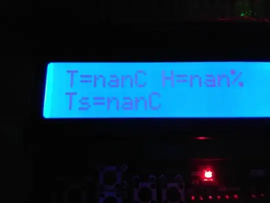

I've recently built my Arduino Incubator, which consists of a DHT22 sensor, an LCD Keypad Shield, some fans, resistors, e.t.c.
I uploaded the sketch, and everything seemed fine. However, when I try to select the temperature and humidity I want, it won't let me change anything, and it says "Temperature: NanC, Humidity: Nan%".
What am I doing wrong? I didn't write the code myself. I copied it from a guy who made his incubator and wrote his code himself. He has the incubator project on github.
As you can see in the pictures he posted, everything appears to be working fine. What would be the problem? I don't have a lot of Arduino knowledge, although I am OK with reading and tinkering with code.
The display below, shows NaN when I try to select my own temperature/humidity. When I see the current temperature/humidity, it works fine. The sensor works with no problems at all, though I didn't connect a pullup resistor. I am going to try adding one. However, to me it seems like the problem isn't that. I get NaN errors when trying to select my own value. The buzzer beeps, the servo turns and the fan works fine. As said above, DHT sensor works and sends the values.

Update - 7/1/2019 Thanks to Jot, everything works fine now! He corrected my code, and he adviced me to reset the values in the EEPROM. I would have given up the project, unless he had helped me. I have now fully finished the build, even though I plan to add some features in the future.

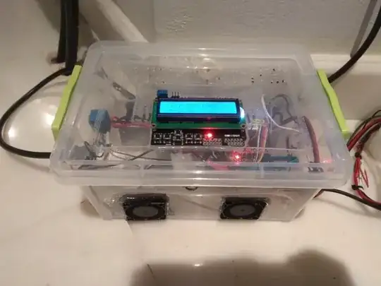

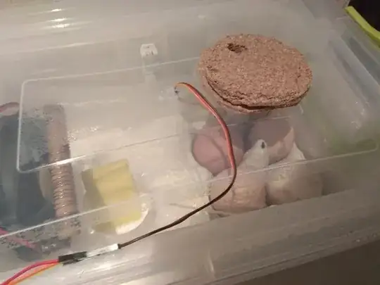

Here are some pictures of the machine for those who are interested (or just curious!):
The incubator working, with the screen turned on: [9]
The "egg hatching" room: (Inside, there is a wet sponge, all the devices and of course, 5 eggs!) enter image description here

@Lefteristhebuilder, you have selected that sketch, but the sketch might not handle problems very well.
Anyone can write code for Arduino and put it online.
At least at Github it is possible that others can write an issue (as you did). The project at Github has 9 stars and the creator showed the project at the Arduino "Project Hub". That is all good, but I'm not very happy with the code itself.
Jot
  • 3,276
