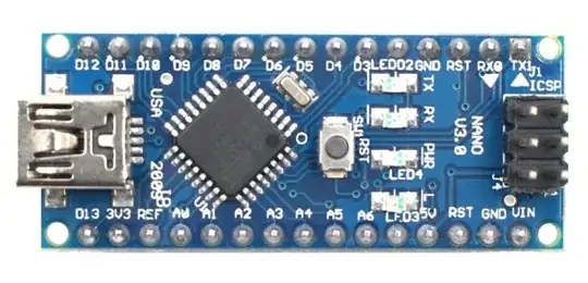

Dev Board: Arduino Nano V3.0

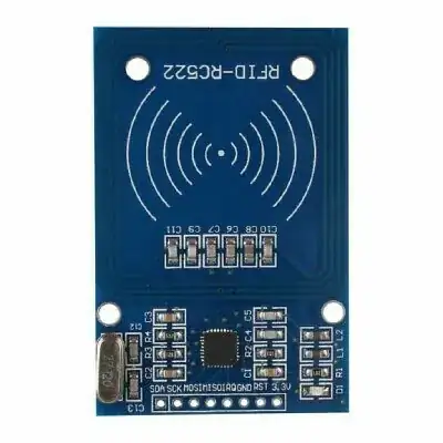

Module: RFID-RC522 13.56 MHz

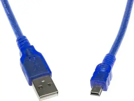

Cable: USB A - USB Mini B

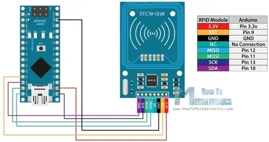

 * Typical pin layout used:
 *             MFRC522      Arduino       Arduino   Arduino    Arduino          Arduino
 *             Reader/PCD   Uno/101       Mega      Nano v3    Leonardo/Micro   Pro Micro
 * Signal      Pin          Pin           Pin       Pin        Pin              Pin
 * RST/Reset   RST          9             5         D9         RESET/ICSP-5     RST
 * SPI SS      SDA(SS)      10            53        D10        10               10
 * SPI MOSI    MOSI         11 / ICSP-4   51        D11        ICSP-4           16
 * SPI MISO    MISO         12 / ICSP-1   50        D12        ICSP-1           14
 * SPI SCK     SCK          13 / ICSP-3   52        D13        ICSP-3           15

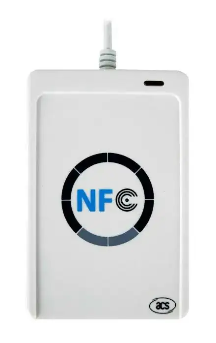

Generic USB-Compatible Mifare NFC Read/Writer
So, you can get these devices that just plug directly into your regular computer via USB, and basically function as an ordinary HID or peripheral device. I have various different ones from when I was investigating the security implications associated with CRYPTO-1 & MiFare Classic access control cards. They all basically work the same, and produce/dump the same standard output.
The thing is, I have little experience with Arduino, and hardware development in general. The Arduino USB Port is obviously used for serial communication with the IDE for programming the MEGA328P, and I can use the IDE's serial interface, plotter, etc. But it doesn't seem to want to play with any of the other applications (MiFare Classic Universal tooKit, etc.) that "just work" with the (unaffiliated) commercial/store-bought devices.

You have to use Arduino Mini and Keyboard.h library which comes with arduino IDE. Arduino Nano does not have HID capable processor.
