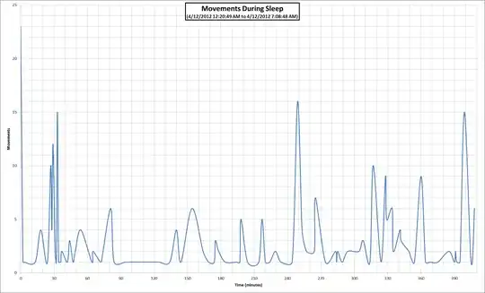

I actually did something like this, using a PIR Motion sensor.
The motion sensor is good enough to detect a person turning in their sleep, and my simple algorithm just counts movements per minute and when its over a threshold (found by trial and error), it sounds the alarm to wake you up.
The image above represents my body movements during a night. The spikes represent a high movements/minute.
Here we see after about 30 minutes body motion was minimal. This suggests I was in a deeper stage of sleep during that time.
The spike at 250 minutes (around 4:30AM) is when I woke up only to realize I could sleep for couple of hours longer. I recall the time being 4:38 when I looked at my clock and I was already facing it. This means I turned around to face the clock but actually "woke up" 8 minutes later to see the time, and then turned back around (indicated by the shorter spike at 265).
The data suggests I was not able to sleep very well (compared to the time period between 30 and 240 minutes) after waking up once and finally got up at 400 minutes (7:00AM), when I shut everything down.
