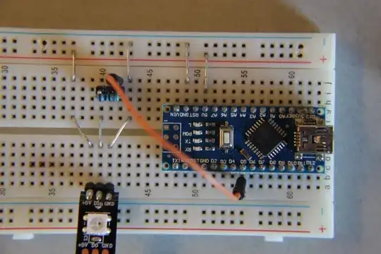

The initial setup.

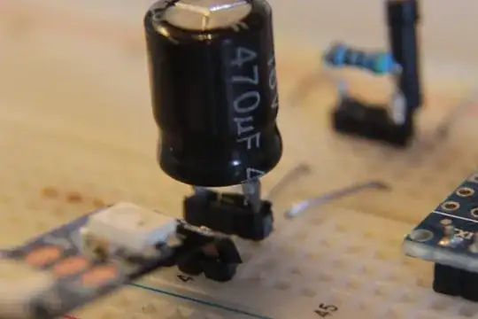

I had no 1000 µF+ Capacitor, so I used what I had, 470 µF, and installed it with the resistor.
The 470µF capacitor between Ground and +5 V

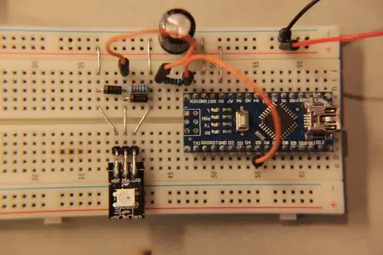

Putting all mentioned above together gives something like this:
Variations on this setup i experimented with
But in the end nothing changed. I tried alot of variations of solutions:
  • With and without condensator between ground and Vin.
  • With and without resistor between data and Arduino, and varied it between 220 Ω to 1 kΩ.

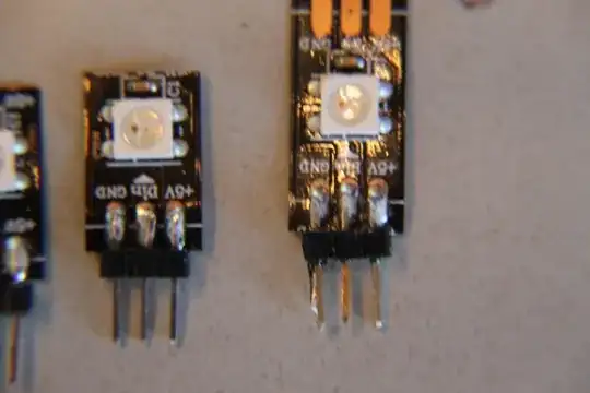

My soldering work, for checking
Any idea where I might be fucking up?

I found (a part of) the problem:
The soldered pin connections at start of the ribbon had leaking current. This was due to the soldering flux remaining around the pins. Rinsing the connection with water carefully solved the problem.
In earlier runs I soldered with flux and simply wiped it off afterwards. Also note that I am generous in flux usage. I do not know how people can make neat solderingwork without it. Just scraping, and wiping with tissues between the connections is apparently unreliable. The flux is water solutable, said the package, so I used tap water for cleaning, but I also tried alcohol at times. Of course by taking care not to make anything wet besides the connection, and drying careful afterwards.
Obviously I checked the look of my soldering earlier as well, and it looked quite neat in my opinion. Yet measuring resistance between pins gave varying results, also compared with unsoldered, which made me wonder why. Cleaning the area around the soldered pins seemed to remove this, which indicates that this may be due to the soldering flux that was remaining. I also heard that flux tends to start flowing again as it heats up under operation, which indicates why the connection seemed good right after soldering, but changed trough time. Perhaps this is why people use these ultrasonic cleaning baths or something.

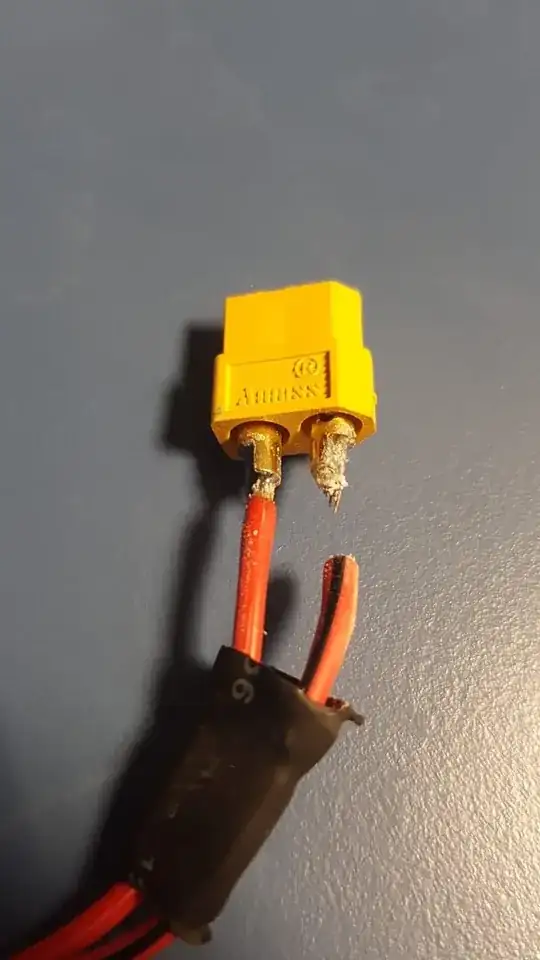

Oh boi! If it isn't the consequences of my own actions!
So this is what SN39 flux does to soldered wires in 2 years. This is a different object, soldered with the same acid based flux thats intended for copper piping, and not for electricals. I have quite some wonky soldering work to replace at my job. Don't be me lads, and only use flux thats intended for electricals.
This wire got rekt

To my understanding, anything connected to the data line (resistors, diodes, etc) is there to protect to data pin from either sourcing too much current to the LEDs or receive a too high voltage.
The capacitor, on the other hand, is there to provide a buffer and maintain the voltage at the right value when current absorption increases with a spike.
If your LEDS burn up and it's always the first one, assuming they are all programmed to lit up of the same color, the most reasonable reason IMHO is you are feeding too much current, in particular in the form of higher voltage through the resistors on the strip.
I suggest you double check the source voltage with no load and with a light load, then try a different power supply and, as last resort, try to lower the brightness intensity of the LEDS: set brightness to 50% and check if it takes like 3 or 4 times longer to burn the LED, which will be a confirmation about my statement.
The first LED is the one receiving the highest voltage in the strip as the strip itself has a non trivial resistance, especially the cheap ones. Lowering the brightness you are actually lowering the amount of time the LED is on and it should prolong the LED life in a non linear way.
If my assumption is correct, this also means you have already partially damaged all the LEDS on the strip, the closer to the power, the more damaged they are.

Check the power supply. It is likely too high a voltage. 5.3V is the absolute max. The resistor is only to prevent signal reflections on long wire runs. Neither it or the diodes are needed for your setup.
