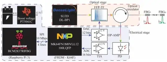

To use a FBG with an Arduino (I advise a ESP32) one needs to have a light* emitter and also a light receiver for the same end of the fiber. To achieve this, is used an unidirectional optical circulator coupled with both emitter, receiver and the FBG.

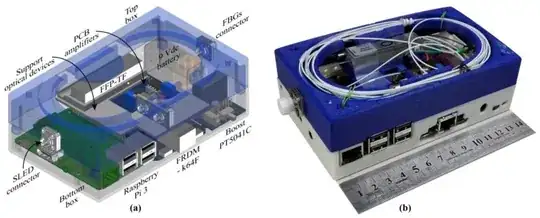

The difficulty is in finding those components suitable or sensing and at the same time inexpensive. That said, here https://europepmc.org/article/pmc/6651577 is an article depicting a portable FBG interrogator using a raspberry pi. The Pi uses a 120Mhz MCU , so a ESP32 MCU is also a suitable option.
in sum, it can be done quite easily.
