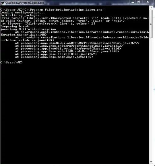

My Arduino IDE is not getting started. It just crashes before opening up. I don't know what the problem is. It was working well enough before without any issues.
This is what I see after running the arduino_debug.exe in the command line
Note: I added a library (DHT) to work with my humidity and temperature sensor and since after then, this issue comes up. I tried to reinstall it like more than 7 times, but the issue still persists.
Please help me with it. Thanks.
The cause of the problem is that you have a corrupted library index file. The solution is to delete the file, which will force the Arduino IDE to download a (hopefully) uncorrupted fresh version from the Internet:
  1. Open the C:\Users\JK\AppData\Local\Arduino15 folder
  2. Delete the file library_index.json
  3. Try starting the Arduino IDE again
