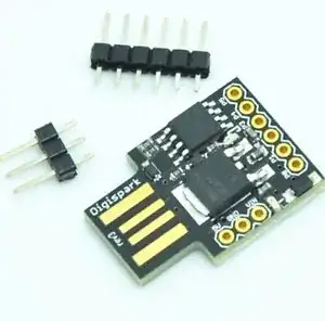

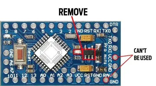

Technically you can use any arduino for that purpose with some modifications. I recommend to go with an arduino Pro Mini and remove the LED and the voltage regulator. enter image description here But if you don't need so much I/O you can go with a digispark Attiny board. enter image description here
