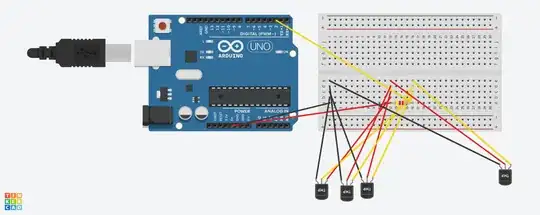

I am very new to Arduino. I want to add about 50 sensors to Arduino R3. I get good readings from 3 sensors, but when I connect 4th one, I get 'No devices found'.
Here is a diagram: enter image description here

The resistor I use is 4.7 kΩ. What should I change to get good readings? And is it a problem to get reading from about 50 sensors?
UPDATE
So after a few trials, I managed to get readings for 18 sensors. I managed to have a mixed topology. What I did is I added close to sensors I didn't get reading a resistor (mainly 4.7k, but also few 100, 1k). At the moment I get occasionally -127 reading from some sensors, but I think I will fix that with CRC check in the program. Thanks for your help! –

First check the sensors
To check that the fourth sensor isn't broken and causing everything to fail, swap them around and then see if it still fails when adding the fourth sensor (although this time it will be a different fourth sensor).
That is to say, if your current fourth sensor becomes the second (and the second becomes the fourth), does it now fail on two sensors..? Or does it still fail on four?
If two (and three) work then the (previously) fourth sensor isn't broken.
Current supply issues
In that case, it could be that your power supply from the Arduino lacks sufficient current and you need to power the sensors with a separate external power supply - separate to the Arduino external PSU (especially when you start to use 50 sensors)1. If you do, don't forget to connect the GND of the Arduino (i.e. the GND of the Arduino PSU) to the external PSU for the sensors. However, for four sensors the current required would only be 4 x 4 mA = 16 mA so it shouldn't be a problem.
If you are using the USB port as your only power supply, then that will most likely cause problems. Make sure that you have an external power supply for the Arduino other than relying only on the USB. Also, again, 16 mA draw for 4 sensors should not be a problem.
Addtional links
There is a similar link to Michel's link to SE.Electronics, on SE.RPi: What is the maximum number of DS18B20 probes that can attached to one input port?
On the Arduino forum, there is this thread, Problem with DS18B20 OneWire and long cables:
I've done more with 1-Wire using dedicated interfaces rather than connecting the device to my Arduino, but I suspect the same principles will apply....
a) You are better off NOT using parasitic mode. The modest extra "trouble" is well worth it.
b) Use cat-5 cable
c) The "magic resistor" (mentioned above) often helps. The right value? Use a little trial and error!
d) Be sure to put multiple 1-Wire chips in a daisy chain, not a "star"... i.e. ONE run of two wires, with 1-wire chips across it, like the rungs of a ladder.... do NOT have several wires leading out from where your Arduino is, with 1-Wire chips on each of the several "rays" of the "star".
I have tested strings of three or four 1-Wire temperature sensors on cat-5 cables of up to... umm, from memory... 40m? They WILL work! But as I said... this was with 1-Wire adapters.
But cable length does not seem to be your problem, if your Fritzing diagram is an accurate portrayal...
In this long thread, someone has issues with over seven sensors, which seems similar to your issue, see Multiple DS18B20 reading isues. In summary, cable length and quality is important, and avoid a star topology.
