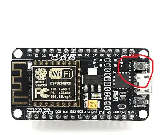

I couldn't find a proper answer on the net so I came here as a last resort. So I want to use the FLASH button as an input in the loop() method.
Is there a way the check if it's pressed or not?
ESP module with the flash button

The Flash button on NodeMCU is connected between io 0 and ground. You can use it as a button. Set pinMode(0, INPUT_PULLUP) and you will read io 0 LOW if the button is pressed.
NodeMCU schema
To put the module in flashing mode, first the Flash button must be held and the Reset button pushed, only then should the Flash button be released. Normally, the reset to flashing mode is done automatically by esptool before uploading over USB. This uses the circuit connected to serial RST and DTS lines.
