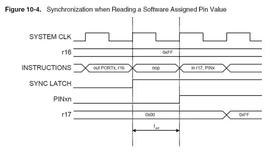

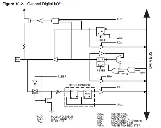

This actually is documented in the datasheet and illustrated by the logic diagram of the typical GPIO, to see what is really going on behind your compiled code you need to look at the generated assembly code and which registers are being accessed:
When you change one bit of an IO port, you are either modifying the 8 bit register on which that bit is mapped using the WRx signal or just the 1 bit register for the pin alone using the WPx signal. When you use the WPx signal to set or clear the bit, you don't need to know the states of the other pins so the discussion ends here. However, when you use the WRx signal to MODIFY a single bit, you need to know the states of the other 7 bits which means that your need to read the 8 bit port. You can either read the port LATCH using the RRx signal or you can read the actual physical pins using the RPx signal. Now when using the RRx signal, no amount of loading or noise on the pins themselves will affect what is read from the output of the port latch but when using the RPx signal, if a previous write to the port is followed by a read of the port, any parasitics or noise on the OUTPUT pins may cause a pin that you think that you just set to a one suddenly becomes a zero.
The reason this happens is because of how opcodes are pipelined. Writes to ports happen at the end of the last instruction clock but reads happen at the beginning so that there is essentially zero time between when you set that bit to a 1 and when you change some other bit (Read-modify-write fashion) so that bit is still a zero when it is read and then immediately written as a zero.
As illustrated below, this can be rectified by inserting a delay between write and read-modify-write opcodes to let the pin states stabilize. The delay must take into account the capacitive loading and noise environment
