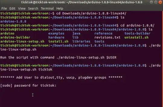

Arduino has added a script to the install to fix this problem. I found it after much annoyance trying to get it to work with all these suggestions.
In the arduino-1.8.8-linuxarm.tar.xz file that you download is a script called arduino-linux-setup.sh
run that from commandline with your user name ./arduino-linux-setup.sh <username>
It'll ask for the root password, and then ask you to reboot. After that you won't have any more port trouble.

Ticktok
As mentioned on the official guide for Linux, you need to run
sudo usermod -a -G dialout <username>
with the <username> replaced with the username of your system. After running this, log out and log in (or in some cases reboot the computer) and you should be good to go.

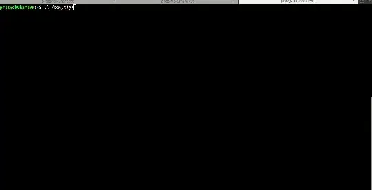

One thing after your plug your USB, check your port with follow
ll /dev/tty*
if you can see my port as ttyUSB0 or with difference name (i.g ttyUSBx / ttyACMx ).
