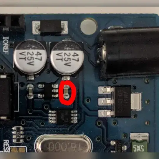

I connected my Arduino Uno to an external power supply, but did not noticed the power supply was on 30 V, I saw the part in the picture smoking and immediately pulled the cable out of the Arduino. now, each time I connect it to some source of power his "ON and "L" light up ("TX" and "RX" are dark) and the ATmega heats up, and it can't receive sketches from my PC. It says just
Problem uploading to board.
Is my board completely dead or I can somehow save it?
The part that smoked is circled

You could try to replace the SMD part, probably a capacitor (I may be wrong), if you can identify which part it is from the schematic (or any marking on the board). However, you may have damaged something else as well. You will only know if and once you have replaced the smoking part.
You may be lucky and only that part has been damaged.
The ATmega appears to be socketed so you could try removing it and putting it in another undamaged board to see if it works still.

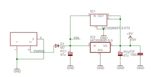

It looks like the smoking part is next to a regulator, IC2 (I am not 100% sure about that), but that would make sense, seeing as it was a power supply issue that caused the smoking in the first place. Maybe just the power supply part of the board is damaged (D1, PC1, PC2, C2, IC1 or IC2 - the two big black and white capacitors, with 47 25V written on them in your photo are PC1 and PC2), and you could slowly work your way through it, checking and replacing the sequential parts (again with the use of the schematic).

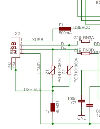

Given that the power LED and L LED still work, there is some hope. Try using the USB input for power and see if that helps as the circuit is different from that of the power jack (no regulator). See VIN AND PWRIN versus USBVCC, on the schematic.
Here is the power jack circuit:
Power jack circuit
Here is the USB input:
USB input
However, if, as you say, the PC can not see the Arduino to communicate with it, it will make programming it difficult.

If the '328P gets hot, it is dead. But, it's replaceable, you can even buy one with a bootloader loaded in already.
The part you circles is a 100nF capacitor, a 10 cents part.
If the PC is not recognizing it when you plug in USB, then the Atmega16U2 that does the USB interfacing is dead. That one is a very small surface mount part that you cannot replace without a hot air rework station, and then you will need a Programmer to reload it with its USB interface program.
And if you killed the 2 regulators, those need replacing too.
Get another board, be more careful next time. I'd get a 7.5V or 9V wallwart for power. I think you can get the wallwart and a bootloaded '328P from www.dipmicro.com, www.sparkfruit.com, www.adafruit.com, etc.
