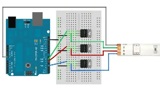

I'm working on arduino based RGB LED strip controller.
This simple schematic was used to control 12V channels via 5V PWM signal from arduino:
https://learn.adafruit.com/system/assets/assets/000/002/692/medium800/led_strips_ledstripfet.gif?1396785823
I have also connected an HC-05 bluetooth module to be able to control it using android phone.
