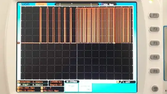

However, during the first few seconds there are some pretty long freezes of the File.write() function (180 ms instead of 50us for normal writes!) which I can identify on an oscilloscope (see picture below, signal low after starting high indicates File.write() phases) and which I can also see in the data if I include in them a milis() timestamp.

I stripped down my code to the absolute bare bones, just writing nonsense data instead of those from the accelerometer. What could be the reason for these freezes? The data rate is the same during the whole run. Isn't the sd card electrically or logically initialized after SD.begin()? It doesn't seem to be a problem with erasing flash memory blocks because it only occurs in the beginning. Even if I restart the application a second time (after staying electrically on all the time) it already shows no freezes anymore. Whereas if I unplug/plug power, the freezes in the beginning reappear.

This does indeed seem to cure the freezes if (in my scenario) I write at least 6 blocks (512 bytes each, i.e. total 3072 Bytes). Remarkably there were always exactly 6 freezes visible in my oscilloscope plots. I don't even remotely know what the meaning of this magic number 6 could be...
