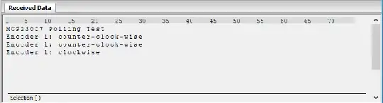

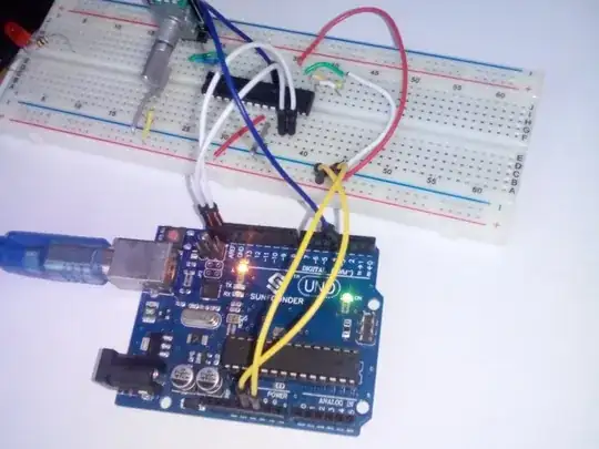

Tests were made using an MCP23017 and a KY-040.
The written library uses a modified Adafruit MCP23017 library and the Rotary library. The Rotary library also handles debouncing by using a state-machine based approach for decoding. The library is a simple header file which defines a RotaryEncOverMCP C++ object, with which a rotary encoder connected to an MCP23017 device can be easily described and managed. It has an example for the polling method and the interrupt method.

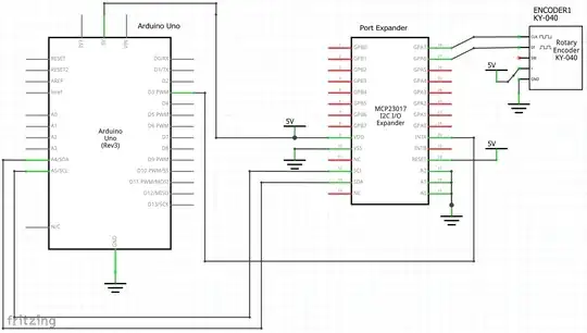

For 1 encoder, one can write down schematic like: (interrupt based)
schem
Since one MCP23017 has 16 ports, we can connect up to 8 rotary encoders to one such device.
