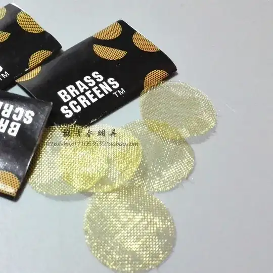

As far as air vents go, one good trick I have used is to simply drill holes (with a steady hand so you get them lined up nice and straight) and glue some fine mesh on the inside. One good source of fine mesh is to go to your local smoking supplies reseller (tobacconist) and buy some "pipe meshes" (the flat ones, not bowl shaped ones) - also available from low-cost online resellers of any old junk (eBay, etc), which look like this:
(Also available in brass). They typically come in different mesh sizes to suit your needs.
