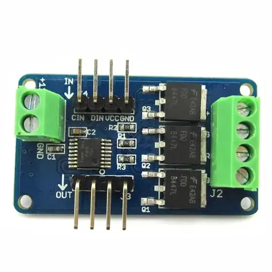

You could use chainable RGB drivers like these:
They are based on the P9813 chip and can be used with the FastLED library.
You can find them on Aliexpress or eBay, if you search for "STM32 rgb".

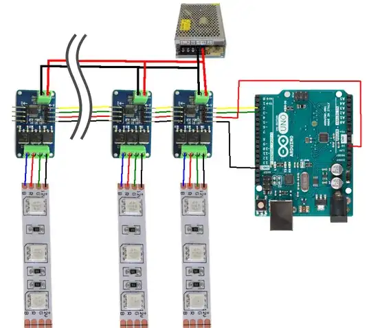

Wiring:
wiring
