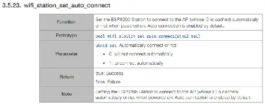

This behaviour can be controlled by using the function WiFi.setAutoConnect(autoConnect) as documented in https://github.com/esp8266/Arduino/blob/master/doc/esp8266wifi/station-class.rst#setautoconnect. This in turn calls the Espressif SDK function wifi_station_set_auto_connect (API reference)
In short: This is normal behaviour. If you want to make sure that your ESP8266 does not connect to any WiFi unless you tell it do it explicitly, call WiFi.setAutoConnect(autoConnect) at the beginning.

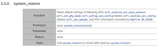

Edit: From within the firmware code, you can use system_restore. The documentation says that it would reset WiFi related data. This should destroy previous settings. The function can be included from https://github.com/esp8266/Arduino/blob/master/tools/sdk/include/user_interface.h within Arduino-ESP8266. I have not tried this myself nor can I say that it actually erases security-critical information from flash though.
