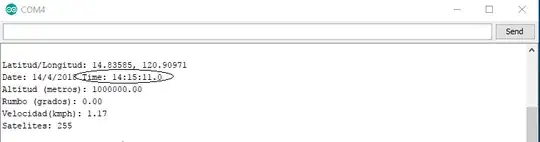

Anyone help? It shows incorrect time. Please help.

Like Majenko's comments suggested, you must shift the UTC time to your local time. The Time library can help you do this.
There are some other problems:
  • You cannot wait 10 seconds without processing the characters. The Arduino receive buffer only has room for 64 characters. The GPS device could have sent 10000 characters during that time, so most of them will get dropped. This prevents the GPS library from parsing a GPS data successfully. It will eventually "see" a complete set of data, sometime after the 10 seconds. You may see data once every 11 seconds, not 10.
  • You are printing the several values even though they may not be valid. For example, if you are not moving, or you do not have good satellite reception, the GPS device may not provide a speed.
  • The Arduino millis() clock will not be synchronized with the GPS clock. You could use the GPS updates as an exact 1-second clock. Simply count 10 fixes as they arrive, and this will mean that 10 seconds have elapsed.
  • You should use a different serial port and/or library. This answer describes the various choices: HardwareSerial (i.e. Serial on pins 0 & 1), AltSoftSerial (8 & 9 on an UNO) or NeoSWSerial (any two pins).
