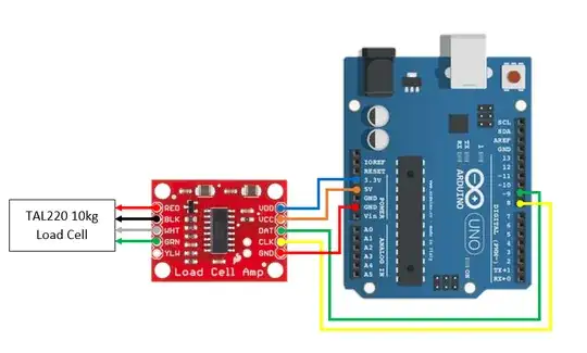

Here is my wiring, with the Arduino Uno connected to a COM port. I am using an Arduino Uno, HX711, and Sparkfun's TAL220 Straight Bar 10kg load cell.

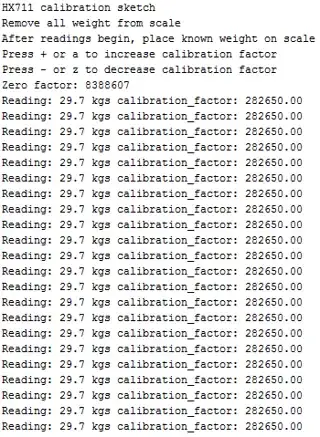

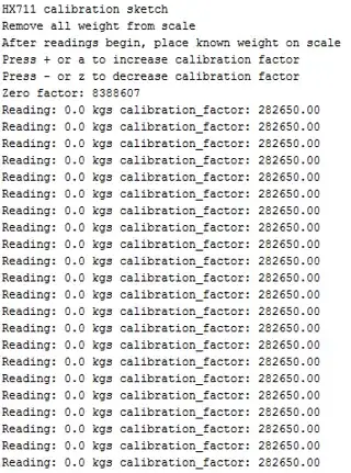

And here is a typical output from the serial monitor (I previously had this load cell functioning correctly, which is why my calibration factor is so different).
Observations:
  • Whenever I upload the sketch and open the serial monitor, the TX LED on my Arduino Uno will light up flashing, but the RX LED stays off.
  • Removing the scale.tare() step will output a constant nonzero value, but the load cell is unaffected by any loading:
image description

  • I have re-soldered the connecting wires to the load cell and replaced the remaining wires, as well as tried multiple Uno Boards and a new USB cord. I have also gone over my wiring and had my labmate check it too (though I will definitely not rule out it being some small wiring/hardware mistake on my part, as I am still very new to Arduino).

The zero factor 8388607 showed up in a similar question on another forum and is associated with the range of the HX711 amplifier. This indicated that my amplifier was broken; I have since replaced it and am now receiving a signal from the load cell.
