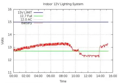

Here is the plot from before then after I moved the input to the correct location:
The actual voltage was falling from 12.7 down to 12.5, and after moving the pin it settled down to the correct reading. Then I turned on the charger while the sun is up. It is tracking the voltmeters perfectly now.

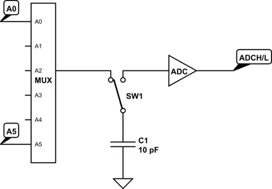

This is normal and expected behaviour. There are a number of factors that influence it, and it will help to understand the basic internals of the ADC.
In simple terms the front-end of the ADC looks like this:
schematic
The MUX selects which pin (A0-A5) is being sampled. Switch SW1 connects the Sample And Hold capacitor C1 to that selected input, which then charges (or discharges) to the same voltage as the input.
After the acquisition period switch SW1 switches position and the ADC circuit is connected to the capacitor. Over a period of clock cycles the ADC works out what the voltage across the capacitor is and stores the result in the ADCH and ADCL registers.
Now - on a pin that has nothing connected to it, what voltage will be across that capacitor when SW1 is switched to charge it? Well, this is where your strange results come from:
  1. Any charge already in the capacitor will still be there (which is why it can be good to connect the unused ADC pins to ground through a resistor, to remove that charge).
  2. Signals, either in wires, IC pins, or the silicon circuitry in the chip itself, will be capacitively coupled with what is next to it.
That last one is the most critical for your results. Capacitive coupling.
Place two wires next to each other and they will, through capacitance, try and get the same charge on them. Under most circumstances that attempt to influence the charge is completely swamped out by what is being send down the wire. But, when there is nothing being sent down the wire that charge becomes noticable. A1 will attempt to "float" to the same level as A0, because they're next to each other. A2 will try and float to the same level as A1, A3 to A2, etc.
If you put a signal in to A0 and plot all 6 inputs you will see each has a progressively lower amplitude copy of the signal. It's hopping, capacitively, between the pins. And all because there's nothing to stop it.
