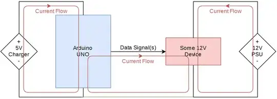

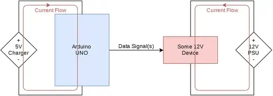

Let’s take a look at the typical circuit from the original question. An Arduino connected to some 12V device (such as some 12V LEDs):
Here you can see the Arduino connected to, for example, a 5V USB charger. It could be a battery, or it could be the USB port on your computer. It doesn't matter. Connected to that is a 12V device which then has its own 12V power supply. Now. Where is ground in that circuit?
The 5V pin of the Arduino is 5V with respect to the ground pin of the Arduino. So seen from the Arduino’s point of view ground is, in the image above, the bottom line of the Arduino’s power circuit (charger -). However, the 12V of the external circuit is 12V with respect to the – side of the 12V PSU. So seen from the point of view of the 12V device the ground is the lower side of the 12V circuit – the “PSU -” connection.
That doesn’t sound too bad, does it? Each device’s power is correct with respect to the power supply it is running off. As far as that goes, sure. However take a look at the data signal going from the Arduino to the 12V device. What voltage is that at?
Well, seen from the Arduino’s point of view, with respect to its ground, since it is generating the signal, it is a 5V signal. But, what about what the 12V device sees? What voltage is that signal with respect to the 12V circuit ground?
Given that voltages aren’t absolute – they are only relative to a reference point within the same circuit, it is impossible to know what the voltage is there.
There’s something more fundamental at play here though which can help you to understand it even better. In the image above there are two red arrows in loops. That is the flow of the current around the circuit (shown as conventional current flow). The key phrase there is around the circuit. Current has to flow out of a supply, through a circuit, and back to the supply from where it came.
In the circuit above the current can flow out of the 5V, through the Arduino, and back to the 5V again because there is a complete loop there. Likewise there is a loop from the 12V supply, through the 12V device, and back to the 12V supply again. But there is no such loop for the signal from the Arduino to the 12V device. If we think of the Arduino’s output pin as a small power supply there really should be some way for the current to get out of the Arduino, through whatever it is connected to, and then back to the Arduino again. There is no way for that to happen in this circuit.

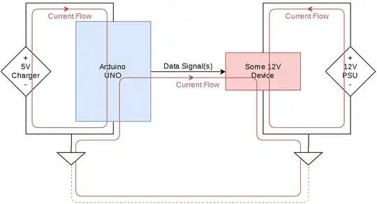

So you connect the grounds. As soon as you do that a lot of things start to happen. Let’s do that now and see how the circuit looks:
The grounds are now linked by the green wire at the bottom. Immediately we can now see a loop has appeared where the current from the IO pin can flow through the 12V device, out of the ground connection of the device, along the green wire, and back up through the ground connection of the Arduino.
In actuality the loop is a branch from the 5V power loop. Current goes from 5V into the Arduino where it splits, some to run the Arduino and some out of the IO pin. From there it goes through the 12V device, down to ground, then joins the current flowing out of the ground of the Arduino to go back to the 5V supply. It’s useful to think in terms of discrete loops though so you can get a better idea of how the ground fits into things.
Also, now, since the ground of the 5V section and the ground of the 12V section are one and the same (in a schematic all points along a line are the same point) any signals generated from the 5V side are recognisable by the 12V side as 5V since the reference point (ground) is the same for every point in the circuit.

This is a classic case where the grounds haven’t been connected together by the user, but there exists another path linking the grounds together. This is most often the earth connection of the computer and the earth connection of the power supply being linked together through the house wiring:
As you can see the current loop still exists, it just takes a longer route. As soon as you remove the Arduino from your computer and power it from batteries – or a power supply that has no connection to earth – the lower part of that loop disappears completely and you are back to the original circuit with only 2 loops. And it stops working.
Connect the grounds together manually, though, and you reinstate that portion of the loop, making it all work again.
