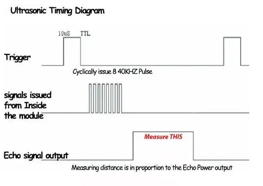

What happens is:
  • You send a pulse of 10 ms with TTL signal. This is the first line in the picture below.
  • Than you call pulseIn. This waits for the echo pulse.
  • The echo pulse will become high when reflected. This happens internally in the module. This is the second line.
  • The echo pulse will stay high depending on the time it took to be echoed back and makes a pin high (echo pin). This is the third line.
  • Than your pulseIn command returns with the time (of the echo pin length).
