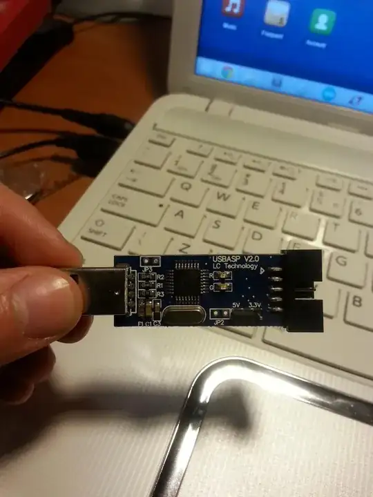

EDIT: I do have this thing I bought for a couple dollars on eBay, which I don't know how and if I need to to use: enter image description here
it is infinitely better than your arduinoisp.
google avrdude / avrdudess.
