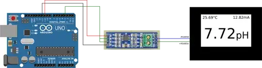

enter image description hereI'm a medium user in Arduino. I baught a pHmeter controller with RS485 output (MODBUS RTU protocol). I want to get pH value read by the controller over RS485 module and Arduino. According the controller's manufacturer, we should operate as bellow: Sent by computer : 00 03 00 00 00 01 85 DB Return from controller : 00 03 02 02 AE 05 58.

I tried this following sketch who does not work. I would like to know if it is the good way to send request to the controller?
