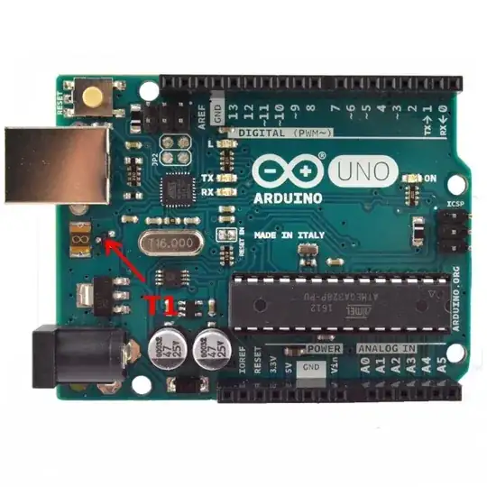

The best way of doing this, if you want your USB connection to still work, is to remove the P-channel MOSFET T1 from the board.
You can't just disconnect the power from the USB port since that power connection goes directly to UVCC on the ATMega16U2 chip. That is used to power the internal USB peripheral (it goes to a 3.3V regulator inside the chip) and without it the USB interface won't have power.
The USB power is connected to the main 5V rail through that transistor, so if you remove that transistor the 5V from the USB remains connected to the ATMega16U2, but is no longer connected to the rest of the circuit.
