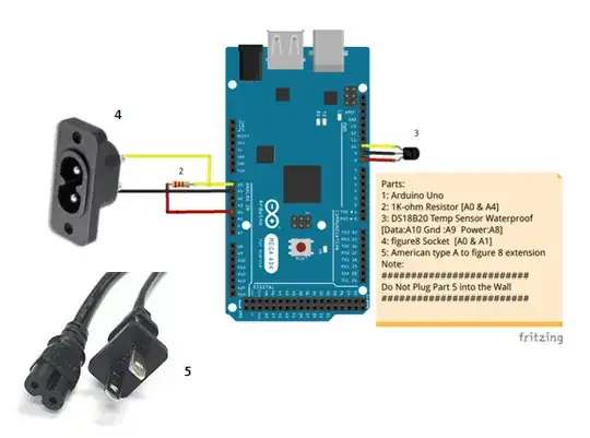

The answer is Three Dollar EC - PPM Meter [Arduino]. I tried it against a consumer level EC meter and got the same results after calibration. It's cheap and simple.
Arduino EC Meter pinout

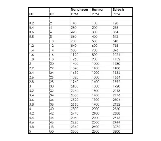

The only warning is that there is several scales in use to measure EC, so results may not be comparable between diferentes devices and you have to read carefully the EC recomendations for your water solution.
EC units
Electrical conductivity can be expressed using a number of different units, but the typical unit is siemens per meter2 per mole (S/m2/mole) or millisiemens per centimetre (mS/cm). The mS/cm unit is generally used in Europe as a guide to the concentration of nutrients in water. In North America, conductivity is converted into a count of the ions in the water using parts per million (which can also be converted into units including mg/l etc.). This is done by converting the EC into a value based on the ions contained in the solution. Fortunately, there is a fixed calculation for the relationship between all these units, which is given in the table below.
Code for the EC meter
  ElCheapo Arduino EC-PPM measurments
  This scrip uses a common USA two prong plug and a 47Kohm Resistor to measure the EC/PPM of a Aquaponics/Hydroponics Sytem.
  You could modift this code to Measure other liquids if you change the resitor and values at the top of the code.

//*********** Converting to ppm [Learn to use EC it is much better**************//
// Hana      [USA]        PPMconverion:   0.5
// Eutech    [EU]         PPMconversion:  0.64
// Tranchen  [Australia]  PPMconversion:  0.7
// Why didnt anyone standardise this?
float PPMconversion=0.5;

    Serial.println("");
    Serial.println("Starting Calibration: Estimated Time 60 Seconds:");
//******************************************* End of Setup
//************************************* Main Loop - Runs Forever ***************************************************************//
//Moved Heavy Work To subroutines so you can call them from main loop without cluttering the main loop
void loop()
    i = 1;
    buffer = 0;
    sensors.requestTemperatures();// Send the command to get temperatures
    TemperatureStart = sensors.getTempCByIndex(0); //Stores Value in Variable
    //************Estimates Resistance of Liquid ****************//
    while(i <= 10) {
        digitalWrite(ECPower, HIGH);
        raw = analogRead(ECPin);
        raw = analogRead(ECPin); // This is not a mistake, First reading will be low
        digitalWrite(ECPower, LOW);
        buffer = buffer + raw;
        i++;
        delay(5000);
    raw = (buffer / 10);
    TemperatureFinish = sensors.getTempCByIndex(0); //Stores Value in Variable
    //*************Compensating For Temperaure********************//
    EC = CalibrationEC * (1 + (TemperatureCoef * (TemperatureFinish - 25.0))) ;
    //***************** Calculates R relating to Calibration fluid **************************//
    Vdrop = (((Vin) * (raw)) / 1024.0);
    Rc = (Vdrop * R1) / (Vin - Vdrop);
    Rc = Rc - Ra;
    K = 1000 / (Rc * EC);
    Serial.print("Calibration Fluid EC: ");
    Serial.print(CalibrationEC);
    Serial.print(" S  ");  //add units here
    Serial.print("Cell Constant K");
    Serial.print(K);
    if(TemperatureStart == TemperatureFinish) {
        Serial.println("  Results are Trustworthy");
        Serial.println("  Safe To Use Above Cell Constant in Main EC code");
    } else {
        Serial.println("  Error -Wait For Temperature To settle");
        Serial.print("Temp start=");
        Serial.print(TemperatureStart);
        Serial.print(" Temp end=");
        Serial.println(TemperatureFinish);
//*************************** End Of Main Loop *******************************************************************//

Make sure to use a factory sealed male plug. If water get inside the plug, the voltage reading will be inaccurate.
That should be possible ... connect +5V to one end, an analog input pin on the other, don't forget a resistor which is high enough not to get more current than allowed. Than measure on the analog input pin the conductivity (value) and act on it.
Afaik the max amperage for an analog pin is 20 mA if I remember correctly. Thus a resistor of V = I * R <=> 5 = 0.02 * R <=> R = 5 / 0.02 = 250 ohm should be ok. This will only occur if the conductivity is 100%. If you get a very low conductivity than you will get very low numbers when reading the analog pin. When you get too less values, you have to lower the resistor value, but you risk of burning a pin when too much current gets across.
