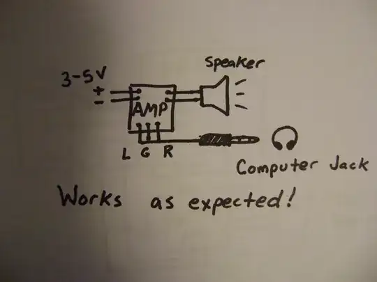

This is the amp/speaker used: https://sites.google.com/site/wayneholder/chiptunes
The amp with speaker works as expected using another similar mp3 player like from a computer or possibly a phone.

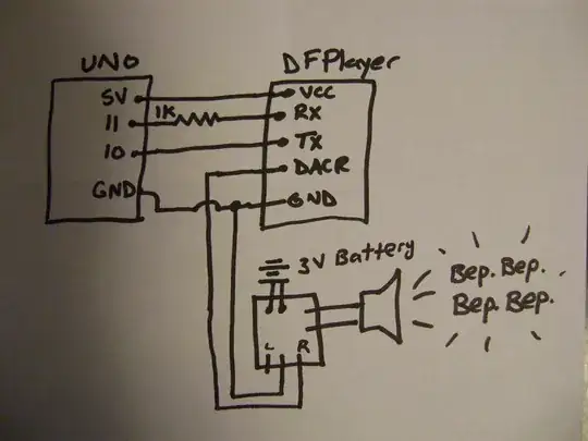

Here we get the bep bep bep bep bep... as the amp/speaker has its own battery power.

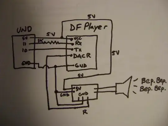

enter image description here Here I made everything as one power source. Bep bep bep bep bep...

The "bep bep bep" you are hearing is power supply noise introduced by the SD card. Every time the SD card reads the power supply dips and the ground raises. This is because these boards have really terrible grounding in their design. There is no coherent ground plane, and the analog audio sections and noisy digital sections both share the same ground with no isolation or filtering between them.
To reduce the impedance of the ground plane you must connect both the GND pins together, and do it with a short wire. Better would be to modify the board itself and solder a wire directly between the two ground pins.
There are also strategic ground points around the place you could also solder directly to one of those ground pins - such as the ground side of the SD card's decoupling capacitors, and the GND pin of the SD card itself (if your soldering skills are up to it - those pins are pretty fine pitch).
The whole issue stems from trying to fit too much into too small a space. The board really should have been made as a 4-layer board with a (near) solid ground and power plane to reduce the power impedance. Better decoupling and filtering on the SD card's power pin (such as a "PI" filter with two capacitors and a ferrite bead, or two capacitors and a small resistor) would have been a big benefit as well.

I found that noise was due to three issues,
  • Forgetting to ground BOTH GND pins on the DFPlayer chip
  • Forgetting to put 1k resistors in the Tx and Rx lines
  • Power fluctuations
Power is the big issue. When I powered my Arduino with a 9v 2A supply all the noise went away. Switching to USB power (5v) caused the noise to return.
My Problem & Solution: I recently attempted to control the DFPlayer with an Arduino Pro Mini and also experienced loud pulsing noises during playback (along with the music file). The pulsing could be seen on a scope on one of the speaker leads. Unloading the speaker did not help, using different power supplies did not help. Also, with regard to tying the two DFPlayer GND pins together, that's not necessary on my board since they are already connected together via the metal shell of the micro SD connector.
However, I noticed that when I attempted to re-program the Mini (or even when I pressed the reset button), there was a short period of time when the pulsing stopped and the music file played as it should. In my case the problem was the data line from the Mini to the Rx pin on the DFPlayer (there was no connection to the Tx pin). I verified this by starting playback (with the pulsing noise) and then disconnecting the Rx connection. That stopped the pulsing and the music file played as expected.
The software solution was to force the transmit pin on the Mini (I'm using soft serial) to a LOW state immediately after sending the Play command. Works fine now.
Update: I had previously connected the Mini serial output directly to the DFPlayer Rx pin without a 1K limiting resistor. Now, with the resistor in place I no longer get the pulsing noise during playback and there is no longer a need to pull the control line low.
