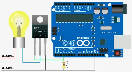

I am working with the project controlling an 25W 12V Car lamp. I have a 12V car battery. I want to control it with the Arduino using a relay or MOSFET.
Any suggestion for my project would be appreciated.

You can use a RFP30N06LE mosfet. It can support up to 60V 30A
Here is a wiring schema
