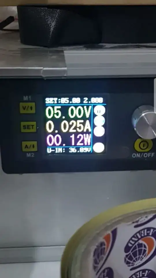

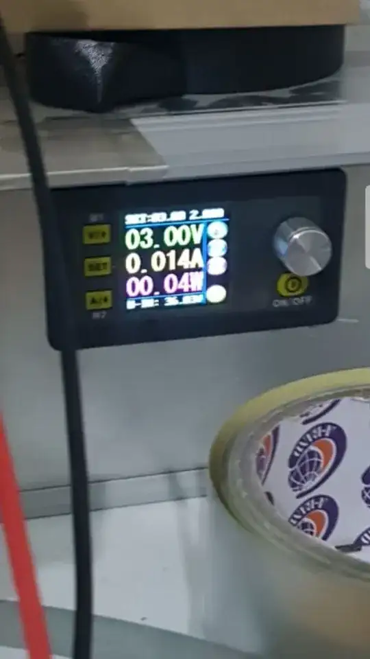

Im feeding 5V pro mini clone with 2 AA battery, to VCC pin, about 3V and it works normally. It consumes few current compared to 5V. consuming at 3V at 5V And you can see what it the setup in here. Also this video can be useful.
