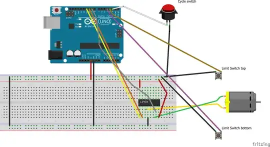

I have a DC motor that will need to use two limit switches to detect end of travel in two directions.
I've read that coding a state machine to do this task is the best method, however I have no idea where to even begin.
Below you'll find a fritzing sketch of my experimental configuration for the code once implemented, and a flow chart.

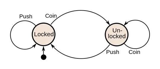

You have created a flow chart. When discussing state machines it is better to use a state diagram.
In this state diagram of a turnstile (from the state machine wikipedia page linked to above) it is observed that the nodes (bubbles) contain the state of the turnstile and on the edges (arrows) is written the condition required to travel in the direction of the arrow to a new state.
For the question asked here, at least 2 nodes are needed to state the direction of the motor. The edges likely will state which arrow is to be used to travel to a new state based on which switch is open or closed. Later, consider adding a new state to stop the motor once an end switch is closed. (Hint: Likely, you will need 2 stop nodes. One for each end-stop switch. The reason being you will need to know which direction the motor is to turn when restarted.)

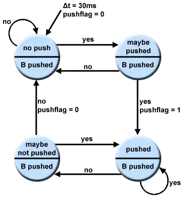

For certain cases, adding a momentary contact switch is complex due to the need to mitigate the contact bounce. This is true when the meaning of activating the switch changes. The end-stop switch meaning does not change so there is no need to mitigate the contact bounce or "debounce" the end-stop switches. However, it is assumed the "Cycle Switch" can start the motor spinning in different directions depending on the history of the motor movement. Therefor the "Cycle Switch" can benefit from a 4 node state machine where there is clearly nodes which output switch-closed and switch-open. But to get to either of these 2 nodes there needs to be 2 other nodes where the switch "debouncing" is handled.
