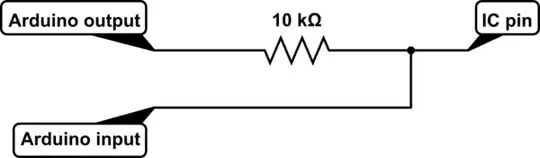

I would connect each of the IC's IO pins to both a digital output and a digital (or analog) input of the Arduino, like this:
schematic
Drive each pin with the digital output, alternatively LOW and HIGH. While doing this, read the pin voltage through your input:
  • If the IC pin is an input, you will have no significant voltage drop through the protection resistor. Your reading should be LOW when driving the pin LOW and HIGH when driving it HIGH.
  • If the IC pin is an output, you will have 5 V through the resistor whenever the IC's output value doesn't match your Arduino output. The reading on your input will be independent of the level of your output.
Obviously, an Uno doesn't have enough I/O pins to implement this idea. You could use a Mega instead. Notice also that with this setup you don't need the joystick input: you could just test for every known IC type until you find one that matches the observed behavior, then display the part number on your LCD.

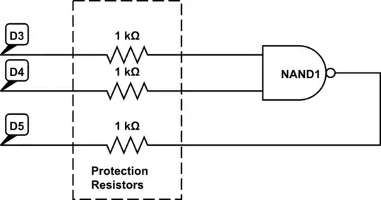

The simplest way to "fool proof" your system (i.e., to prevent damage by a fool, not make it so it always works right even with a fool) is to add a resistor to each connection. The resistor should be sized so that if an IO pin is HIGH and it's connected to a LOW output on the chip the current flow is below the maximum allowed by both ends.
schematic
If D5 is set HIGH and the output of the NAND is LOW the voltage difference (assuming a 5V Arduino) would be around 5V. I=V/R, so 5/1000 is 5mA - way below the maximum of 25mA (40mA burst) of the Arduino.
It won't tell you that you have connected the wrong chip, but it will protect both the chip and the Arduino in such an event.
Since it now doesn't matter if the wrong chip is selected you could in fact cycle automatically through each of the chips testing each on in sequence until you find one that gives the correct results. No need to select a specific one - if no chip matches then it's a faulty chip.
