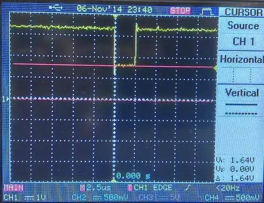

Consider the following minimal example, where I set pinMode before calling SPI functions:
#include <SPI.h>
  pinMode(10, OUTPUT);
  SPI.begin(10);
  SPI.setDataMode(10,SPI_MODE1);
  delay(1000);
  SPI.transfer(10,1);
Now when SPI.transfer(10,1) is called in loop(), I always see that the slave selected pin goes down to 1.65V, but not 0 as it should! (see image below)

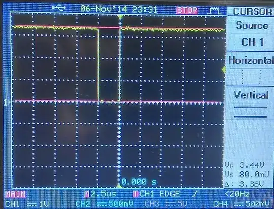

pin mode set before calling SPI functions
If we don't call pinMode(), like this:
#include <SPI.h>
  SPI.begin(10);
  delay(1000);
  SPI.transfer(10,1);
We get what we would expect when calling SPI.transfer:
pin Mode not set
Is that a bug or do you have an explanation for that behaviour?
