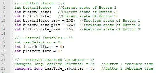

For some reason, the compiler is convinced that the variable lastTime_Debounce1 in the second IF-statement, on Line 54, has not been declared in-scope. I don't understand how this is possible, since the variable in question is a defined and initialized global.

The backslash in your comments are the problem. As per C++ language definitions, a \ at the end of the line is interpreted as a "line continuation". Thus, your comment gets continued in the next line and your variable declaration and initialization is commented out.
This is apparent when opening your code with a good syntax highlighting program, like Notepad++.
Removing all \\ from the end of the comment line solves your problem.
