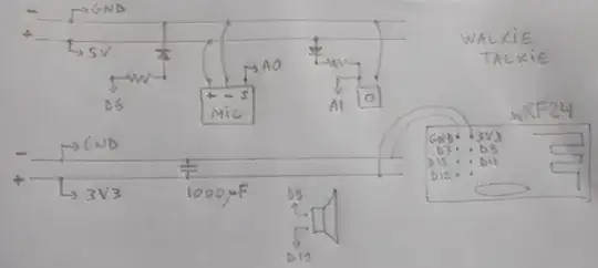

This is a walkie-talkie project and this circuit really worked, voice can be transmitted from one nRF module to another nRF. Additionally, I want to observe how well the signal strength is, by lighting up an LED.
