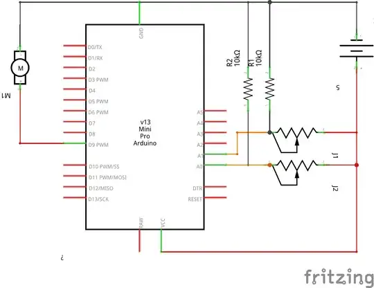

I'm getting some very strange behaviour from a Haptic feedback system I'm trying to make. The test code works fine as a Multiple-In One-Out in the main loop, but once I moved the code to the Struct, I ended up with very erratic behaviour on the motor that is completely independent of pressure on the FSR and bears no correlation.
Bizarrely, the serial data that I have been using to debug the code is also largely unusable now.
Does anyone have any idea what's going on? (p.s. Don't worry about the current draw of the motor, I'm using tiny mobile phone vibration motors specifically for their low voltage and current draw)
Note: All '[' chars in the code and log have been replaced with '<' and ']' with '>' so that I can actually post this question without the site screaming at me about more than 8 links.

Circuit Diagram
