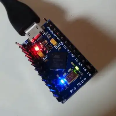

When I now run the reset procedure for Arduinos with integrated USB (open the COM port of the Pro Micro for example in PuTTY at 1200 bit/s and close it again), the LEDs start flashing rapidly and the Arduino disappears from the Windows Device Manager.
Hover for a (slightly annoying) image:
LEDs flashing
So then I grabbed a second, identical Pro Micro and uploaded the Blink sketch into it. It was also previously unprogrammed. The sketch executed, but when I now do the reset procedure, it exhibits the same behavior now (flashing LEDs).
