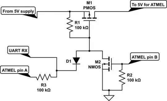

I don't think you can use the HW peripheral, so IF you really want/need low power you will need something like this (note: this may be very overkill for your application)
schematic
NOTE: I assume the "serial" is a UART and its "rest" voltage is 5V. Choose the PMOS so that it is turned on with about 3V.
In this case, the circuit is normally powered off. When you receive a START, the PMOS start conducting. The ATMEL will then pull pin B to 5V, thus keeping the circuit powered. Through pin A it can sense the UART.
In this case, since you miss the start bit, you won't be able to use the usual libraries or peripherals. You can, however, implement a software uart which can avoid the first start bit to overcome this.
