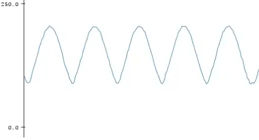

With that code, I got a nice result of sinusoidal graph represented audio value up to 4000 Hz like this :
But one thing that didn't work is if I change the volume or frequency (while displaying data) of analog input (jack audio), the graph I print and display via serial plot audio won't change. So I had to close it and open again to see the change. The question is how can I achieve the continuous and real time reading of this ? Thank you very much.
