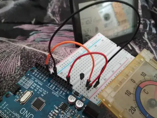

I am trying to read a LM35 temperature sensor with Arduino UNO which I got as a gift. The issue is the fact, that my readings of sensor are, well, suspicious at least - they jump with each reading some 5 °C up or down.
I had used several posts how to wire the thing to Arduino board and for and program the reading (1, 2, 3) and produced the code posted below. The sensor reading fluctuates really a lot - it jumps by some 3 to 7 °C after each reading regardless of reading frequency (tested with reading each 0.5 s, 1.0 s or 2.5 s). (Unfortunately I do not own a multi-meter to check actual values.) To mitigate the issue I implemented an averager, but underlying problem stays. Expected values are something like 23 or 24 °C as measured by digital weather station and bimetallic thermometer respectively.
Have you met this before ? Do you have any ideas what might be source of this ? I am beginner to electronics as well as to Arduino, trying to learn and mainly understand it.

Experimental setup

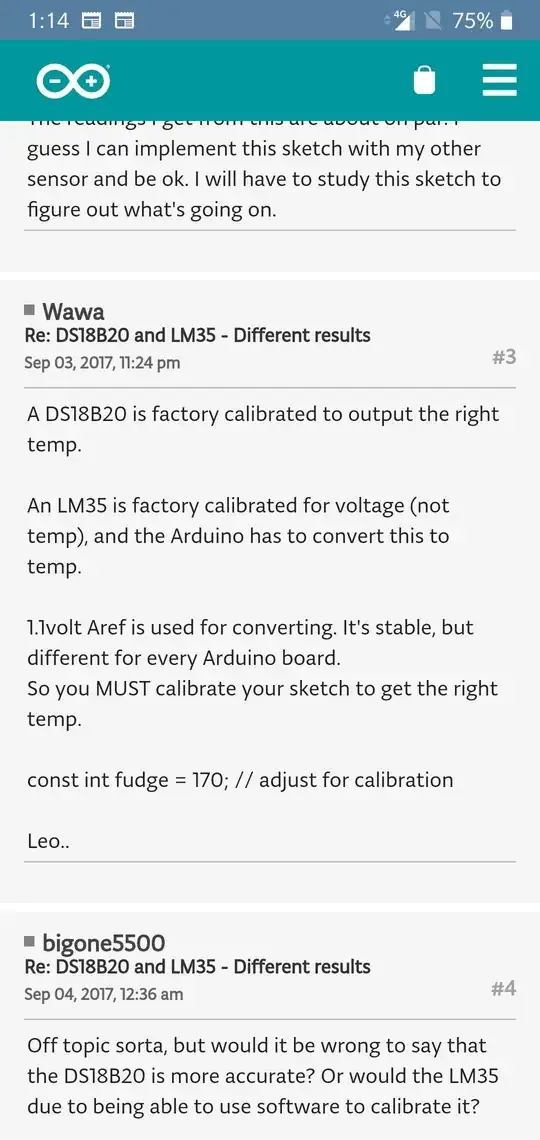

Also the LM35 is factory calibrated for voltage. So you have to calibrate it according to the Arduino you use. I would recommend the ds18b20 as it's calibrated for temperature. Using the Dallas temperature library makes it easier to use as well
I found this on the Arduino forum some time back

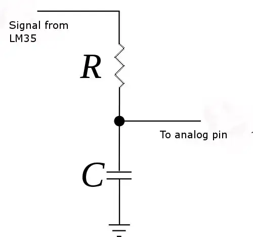

If issue with readings persist, put an RC circuit for measuring the voltage as it is similar to averaging done in software. Another thing that you can try is replacing the LM35 with a new one as sometimes it could be faulty or you might have damaged it(has happened with me). However u can easily check this by measuring the voltage at the sensing pin whether it corresponds to what you are getting. If you are working with electronics please invest in a multi-meter as it will help you in all your projects
