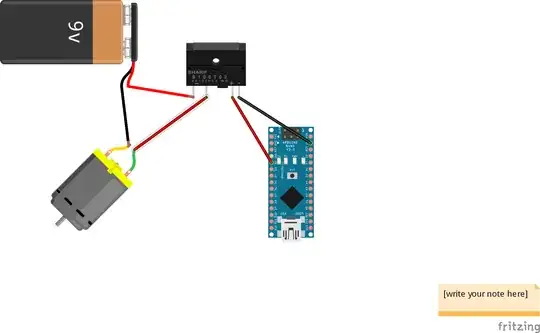

I am trying to wire a fss1-102z 5v ssr relay to my arduino nano but i cant get it to work here is my circuit. It stays stuck on and i cant get it to turn off.

According to its datasheet, the FSS1-102Z doesn't work with DC-voltage. Also the minimal voltage required is 50VAC. Here is the excerpt from the datasheet:

  • Is it really 5v relay?
  • Need your code.
  • Check your output is really 5v.
You do a lot of mistakes:
